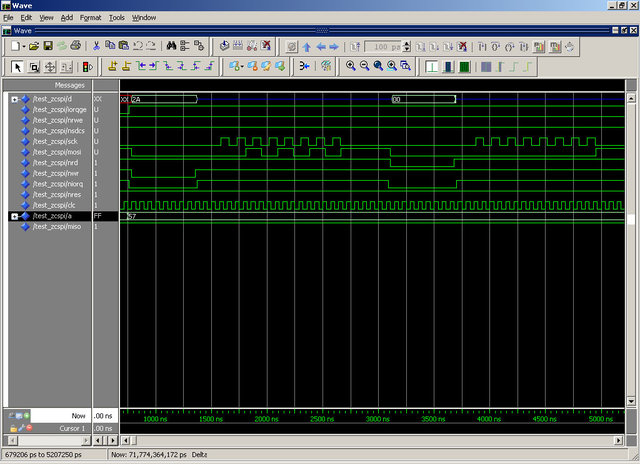

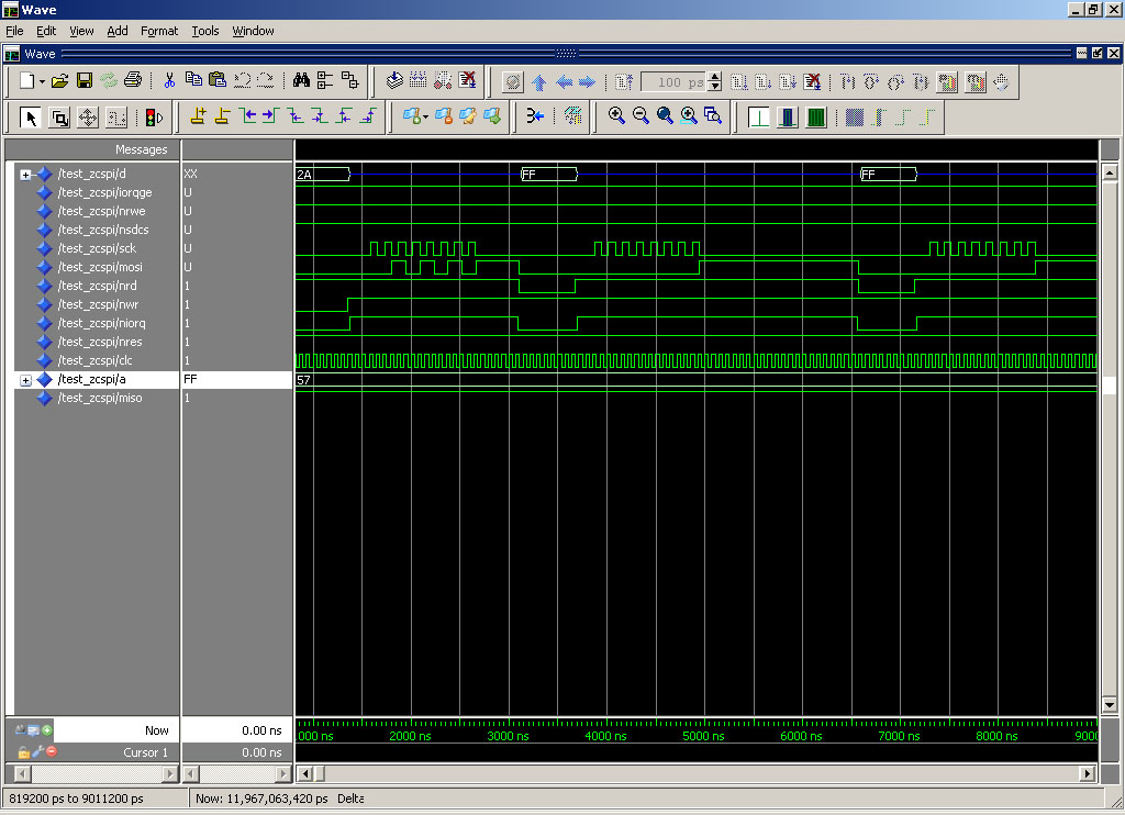

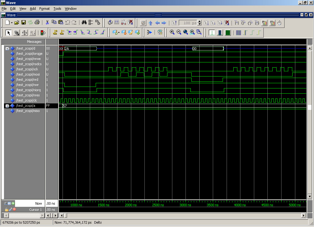

Postby keeper » 17 Sep 2010, 16:18
За сцылки всем спасибо, разбираюсь, вот напоролся на странную проблему...
кусок сорца:
Code: Select all
signal BITS_COUNTER_EN          : std_logic;
signal BITS_COUNTER             : std_logic_vector(3 downto 0):="1000";
signal SREG_CLK                 : std_logic;
signal SREG_SHIFT_CLK           : std_logic;
signal SREG_CLK_SYNC            : std_logic;
signal SREG_DB                  : std_logic_vector(7 downto 0);
signal DIV                      : std_logic;
signal SPI_CLK                  : std_logic;
        --spi
        -- PORT_57_CS = 1 when A = 57h and nIORQ = 0
        -- PORT_57_WRSTB = 1 when PORT_57_CS = 1 and nWR = 0
        SPI_CLK <= DIV;
        BITS_COUNTER_EN <= '0' when BITS_COUNTER(3 downto 0) = "1000" else '1';
        SREG_SHIFT_CLK <= SREG_CLK_SYNC and not SPI_CLK;
        SREG_CLK <= not PORT_57_WRSTB when PORT_57_CS = '1' else SREG_SHIFT_CLK;
        SCK <= '0' when BITS_COUNTER(3) = '1' else SPI_CLK;
        CNT1: lpm_counter
            GENERIC MAP (lpm_width => 4, lpm_direction => "up")
            PORT MAP (clock => not SPI_CLK, aset => PORT_57_CS, cnt_en => BITS_COUNTER_EN, q => BITS_COUNTER,
                data => "1000", aload => not nRES );
        SREG1: lpm_shiftreg
            GENERIC MAP (lpm_width => 8, lpm_direction => "left")
            PORT MAP (data => D, shiftin => MISO, load => PORT_57_CS, shiftout => MOSI,
                q => SREG_DB, clock => SREG_CLK, aset => not nRES, enable => '1');
        D <= SREG_DB when PORT_57_RDSTB = '1' else "ZZZZZZZZ";
        process(SPI_CLK)
        begin
            if SPI_CLK'event and SPI_CLK = '1' then
                SREG_CLK_SYNC <= not BITS_COUNTER(3);
            end if;
        end process;
вот результат в modelsime: байт #2A выплевывается нормально, а по MISO (оно в тестбенче всегда в "1") всасывается какая-то нулевая хуита...
переделываю исходник:
Code: Select all
       SREG1: lpm_shiftreg
            PORT MAP (data => D, load => PORT_57_CS, shiftout => MOSI,clock => SREG_CLK, aset => not nRES);
       SREG2: lpm_shiftreg
            PORT MAP (shiftin => MISO, q => SREG_DB, clock => SREG_CLK, aset => not nRES);
в результате читается с MISO правильно, но на MOSI вылазит "0":
wtf?
keeper
Posts: 286
Joined: 12 Jun 2010, 22:31
Postby deathsoft » 17 Sep 2010, 18:10
keeper wrote:wtf?
У тебя случаем вход последовательного ввода в сдвиговый регистр не запрещен? (Сигнал разрешение сдвига). Если запрещен - то вся входная информация теряется, а из регистра считывается ноль - который там при резете был. Сделай в модельсиме вывод содержимого регистра сдвига (то что у него там внутри, массив из триггеров).
