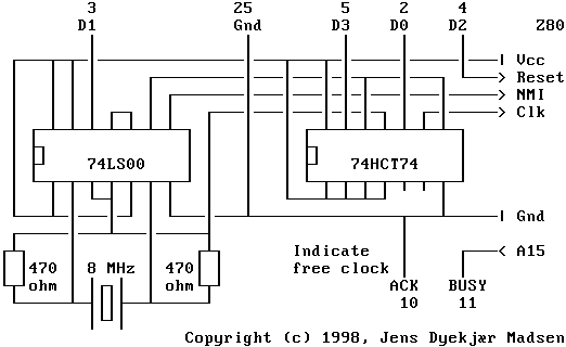

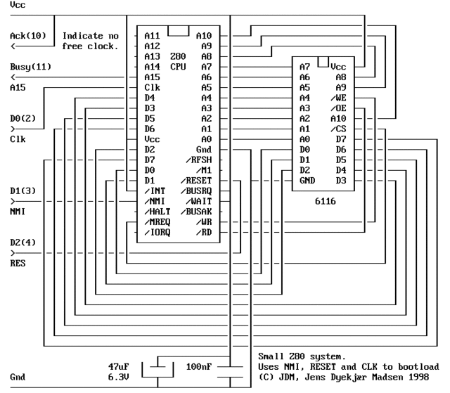

The code, and the schematic, is attached to this document. Only the circuit schematic is needed. Oscillator circuit is not needed, but circuit is clocked by the PC if no oscillator circuit is used. Remember decoubling Z80 and 6116, by using capacitors under the chips if using sockets. Ack is used to indikate if oscillator circuit is used, or if all clocks is controlled by the PC.
Circuit - 2 chips only
Oscillator (not needed)

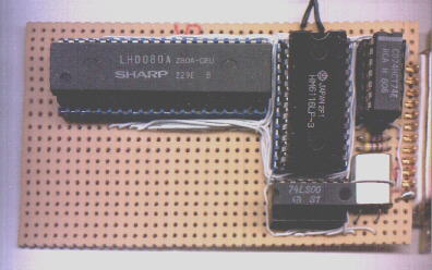

Photo (decoubling is under the chips).
